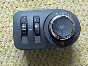

As far as i have understood the problem is that the Astra lightswitch has no option for manually turning off the light.Montanelasecoflex wrote: ↑Mon Aug 12, 2019 12:39 pmHello everyone,I've read about the light switch of the Corsa E, I just didn't understand what it did, my light switch already has a slider to controll the brightness of the interior displays even tough it doesn't affect the sensibility of the light sensor and with my actual light switch I can disable the auto headlights my biggest problem is that it doesn't disable the auto diming of the interior displays.

The Corsa one has a position where you force it to be "off", no matter what the light sensor might tell the car
On this picture you can see a setting to the right of the AUTO setting, that is "off"
This is the standard Astra one... (Please ignore the difference due to one having fogs and the other not, and one being for a left hand drive car and the other a right hand)

Yeah thanks a lot for the photos and I see the difference, so on the corsa switch you can just turn the lights "off" including the LED DRL and with it the interior display diming?astraowner wrote: ↑Mon Aug 12, 2019 3:47 pmAs far as i have understood the problem is that the Astra lightswitch has no option for manually turning off the light.Montanelasecoflex wrote: ↑Mon Aug 12, 2019 12:39 pmHello everyone,I've read about the light switch of the Corsa E, I just didn't understand what it did, my light switch already has a slider to controll the brightness of the interior displays even tough it doesn't affect the sensibility of the light sensor and with my actual light switch I can disable the auto headlights my biggest problem is that it doesn't disable the auto diming of the interior displays.
Funny, that photo is the exact same astra switch I have (left hand and only back fog light) and if I put the switch on the "middle" position it will only turn the LED DRL lights on which is good enough not to be riding along on a sunny day with the medium lights on however, even in that middle position the interior display will still auto dim.
The day riding lights are there for a reason (and are mandatory for some years now) but if it would prevent the interior displays from going into low brightness it would be worth it. Can you link the part number or ebay link to the one compatible with the astra since someone said there are 2 versions of the switch? Also I don't have front fog lights, even if I find one with the front fog button could I still use it?

The Corsa switch is one of the best mods I made to the car. Strangley the auto setting works far better with the Corsa switch which I noticed immediately, far less sensitive.

Hey can you confirm that when you put the switch on the "off" it turns off the auto and DRL LED's aswell as the auto dimming of the interior display lights?
Re: Automatic Lights "Problem" - Won't turn off.
No mate, just the headlights. It does NOT control the interior lights, unfortunately. For this one there is no solution yet. Personally, I dont see why someone would be annoyed by their headlights staying on, you dont see them from the inside, but thats just my opinion.

Thank you for your answer pepe, then to be honest I don't see why you would use the corsa switch except by the reports that the automatic headlight works better with it.
The original Astra switch also turns out the main headlights leaving the DRL on but that isn't even a problem for me, some people might not like to be ridding with the medium beams on because... reasons, the only one that occurs me is that it cuts the bulb lifetime.
But the main issue if that neither of them can turn off the auto dimming of the interior lights, which is that's my main problem.
Guess I'll just have to live with it then.
