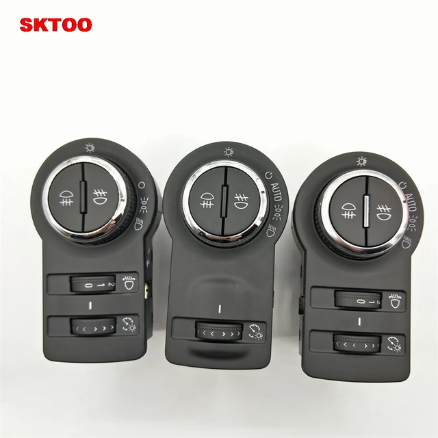

Will this one feet on my Astra K, the middle one ? (I own IntelliLux with auto-leveling):

oastra wrote:
Sun Jun 17, 2018 5:32 pm
(img)
"For Buick Encore Chevy Cruze Malibu Without AUTO GM13301749"
Housing is completely different...
viewtopic.php?f=8&t=2288&start=80#p35461
oastra
Posts: 349
Joined: Sun Jan 24, 2016 8:16 pm
Re: Auto lights disabling
Post by oastra » Tue Jun 19, 2018 1:54 pm
Yes I saw that later in the day... pffff
